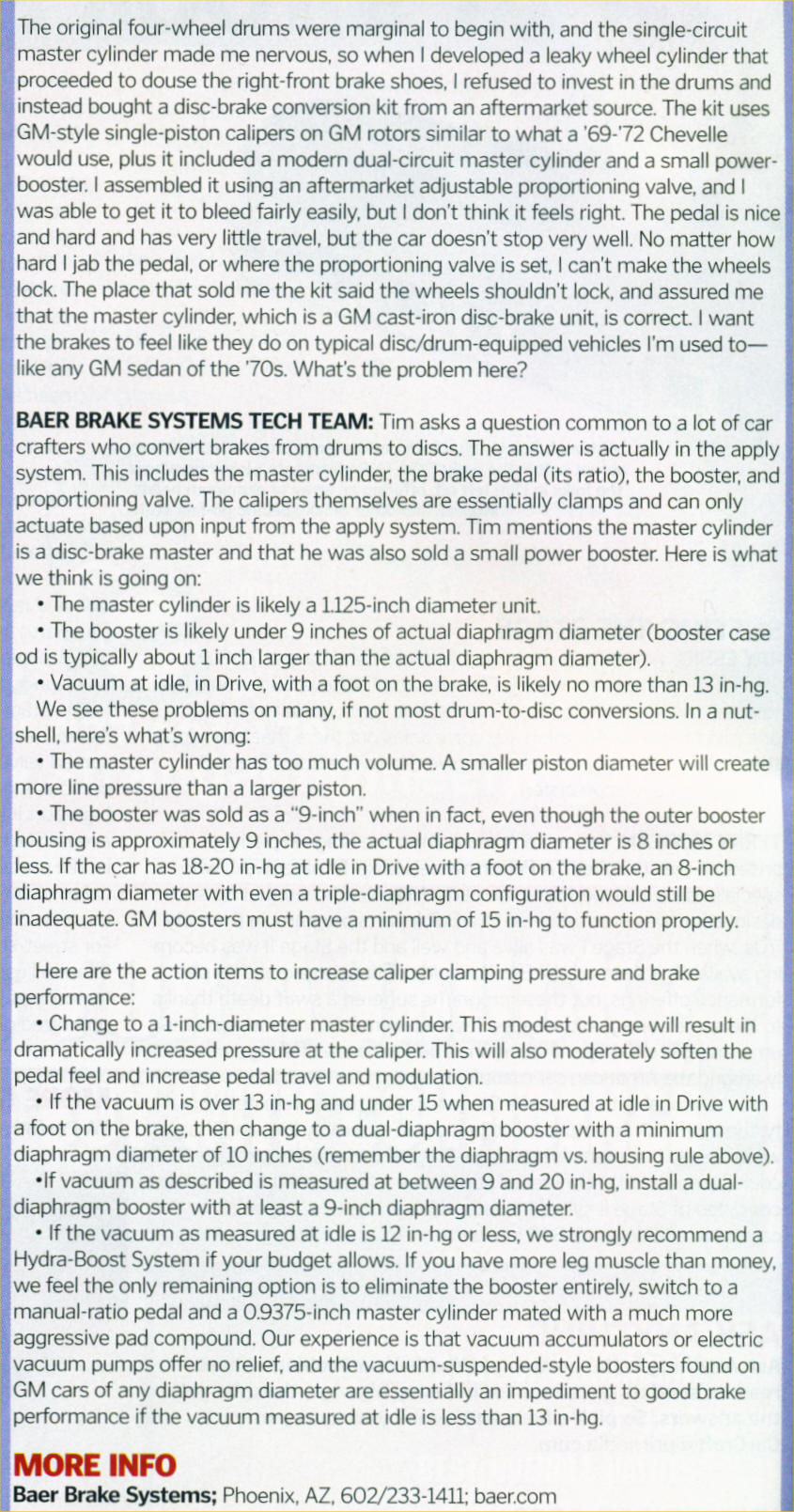

The following was taken from the November 2005 issue of Car Craft Magazine and is the answer to a brake tech question. I think the comments regarding master cylinder piston size and the required booster sizes and available vacuum are interesting.
