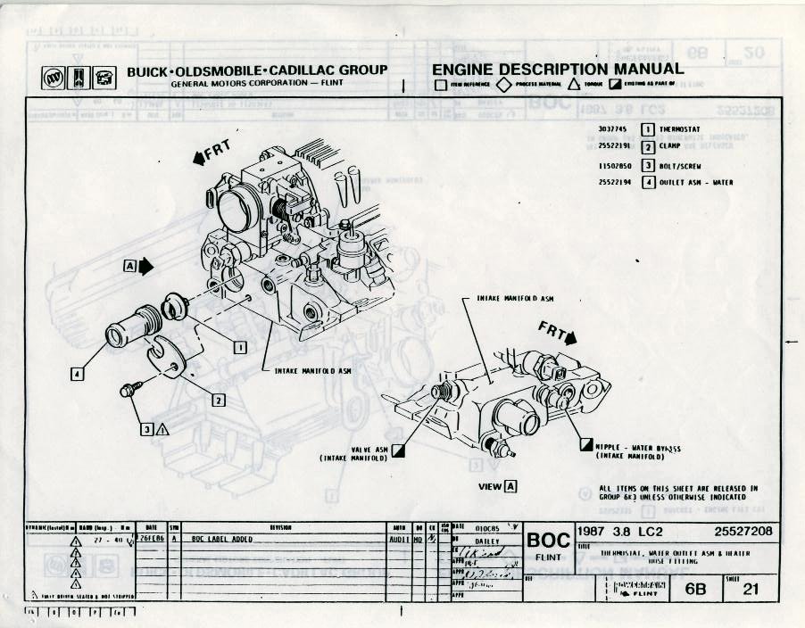

Here is a drawing from the engine assembly manual showing the location. As you can see, the thermostat sticks into the opening of the intake and the water outlet then is pressed into the intake and retained by the clamp. The outlet has a big rubber o-ring at the end that seals the unit and prevents leaks.

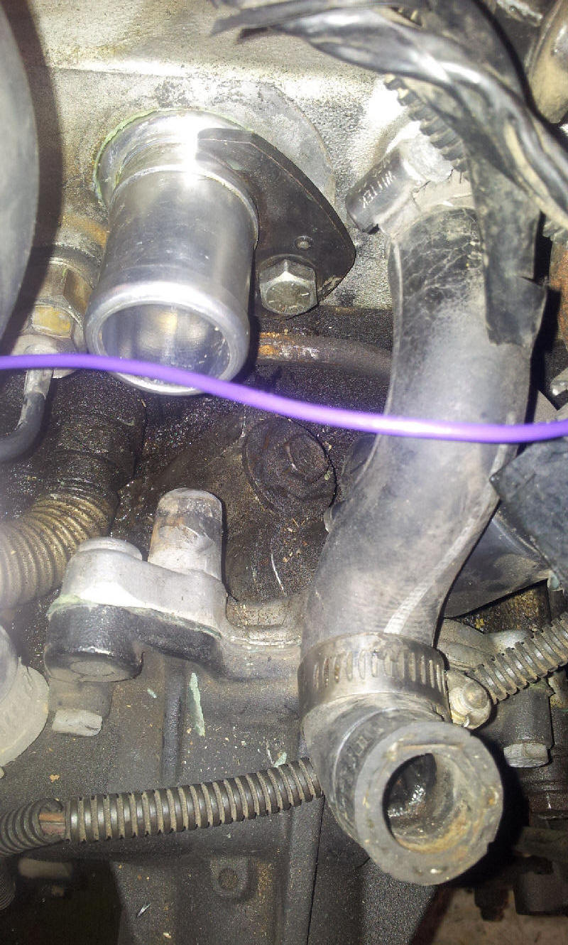

Here is a picture of a new outlet installed over the new thermostat and the hose is ready to reinstall. Note that I had to remove the turbo inlet pipe and the up pipe to the throttlebody to get access to the outlet. I also had to remove the S hose (bypass hose) in order to get to the bolt in the retaining clamp. I strongly suggest that this is a good time to replace the S hose while it is readily accessible. Might as well replace the upper radiator hose as well. Took the picture before I cleaned up all the oil that had accumulated there. Still trying to figure out where it came from.

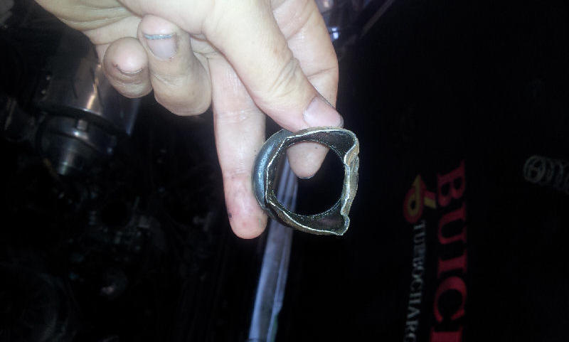

Now, that was really easy, huh? Actually, it can be a major pain in the rear because the water outlet can be next to impossible to remove after two or three years. Knowing this, I bought two outlets along with two thermostats before I started this project. Below is the picture of the one I pulled out. After a lot of wiggling and no progress, I put the pliers down and got the vise grips out. Even then it was not easy. Be prepared! For one that has not been installed too long, try leaving the radiator hose attached and use it for some added leverage when wiggling. That often works very well.
I managed to get the one out of the other car without destroying it but I had it out two years ago. I always smear a coat of grease over the rubber o-ring before pushing the outlet back in the intake and I clean out the intake opening to remove anything that might nick the o-ring.
