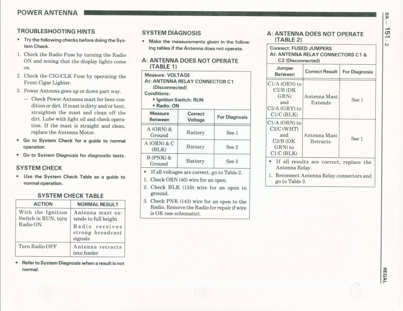

For a quick means to check the antenna motor itself, unplug the antenna connector under the hood and apply power to the dark green wire while grounding the gray wire.  The antenna should go up.  Then apply power to the white wire and ground the dark green wire.  The antenna should go back down.  This corresponds to Table 2 below.
