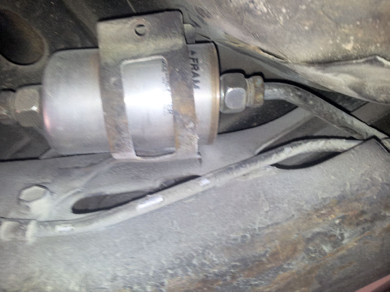

If one is not familiar with the fuel filter location, it can be a bit time consuming to find as it is tucked up inside the frame rail about two feet in front of the driver's side rear wheel behind a dropped down portion of the floor pan. As the picture shows, there is not a lot of access room to the front fitting.

As you can see by the picture, I don't live in a bad rust area. If you do, and the filter was not routinely changed by the prior owner, you may be in for a real job when it comes to breaking the fittings loose. Soak them several times with AeroKoil or PB Blaster over a period of days before you get serious about changing it.
