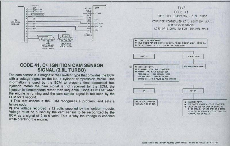

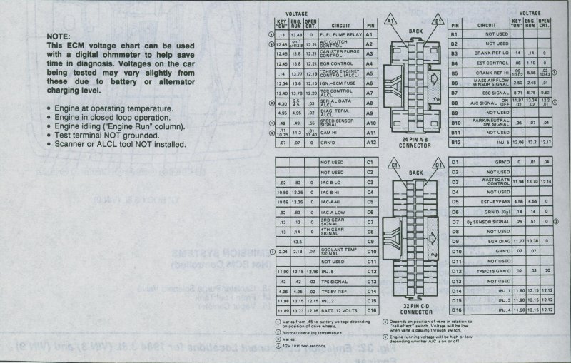

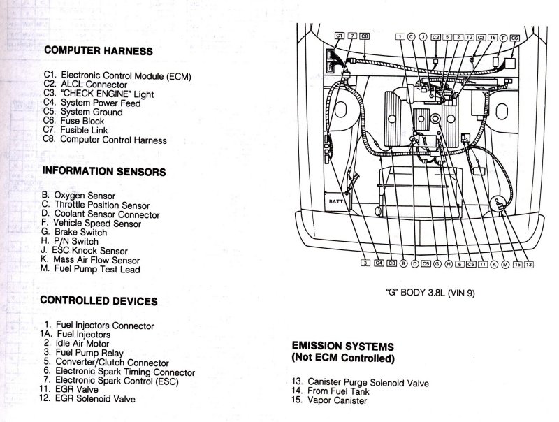

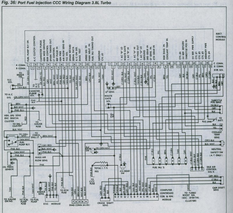

ECM Wiring-2 Pages

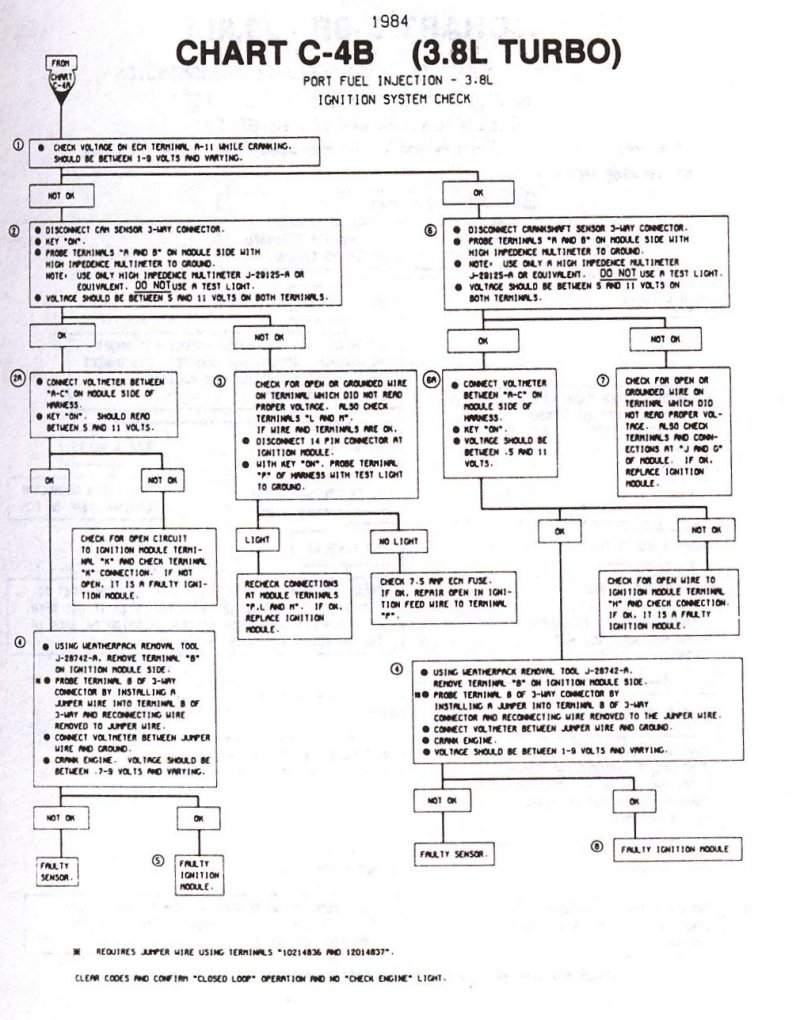

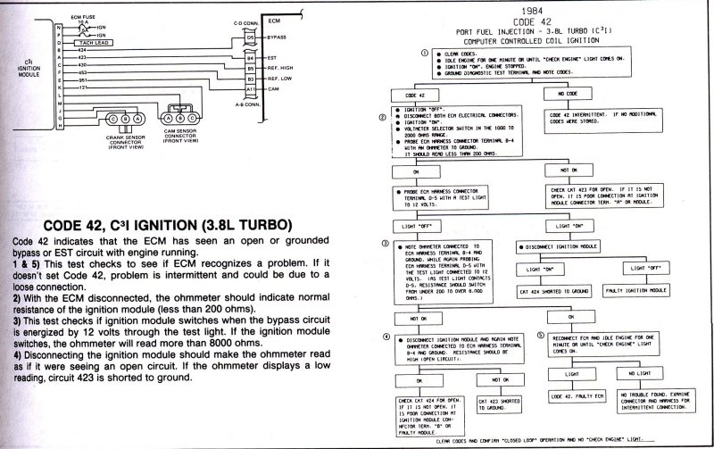

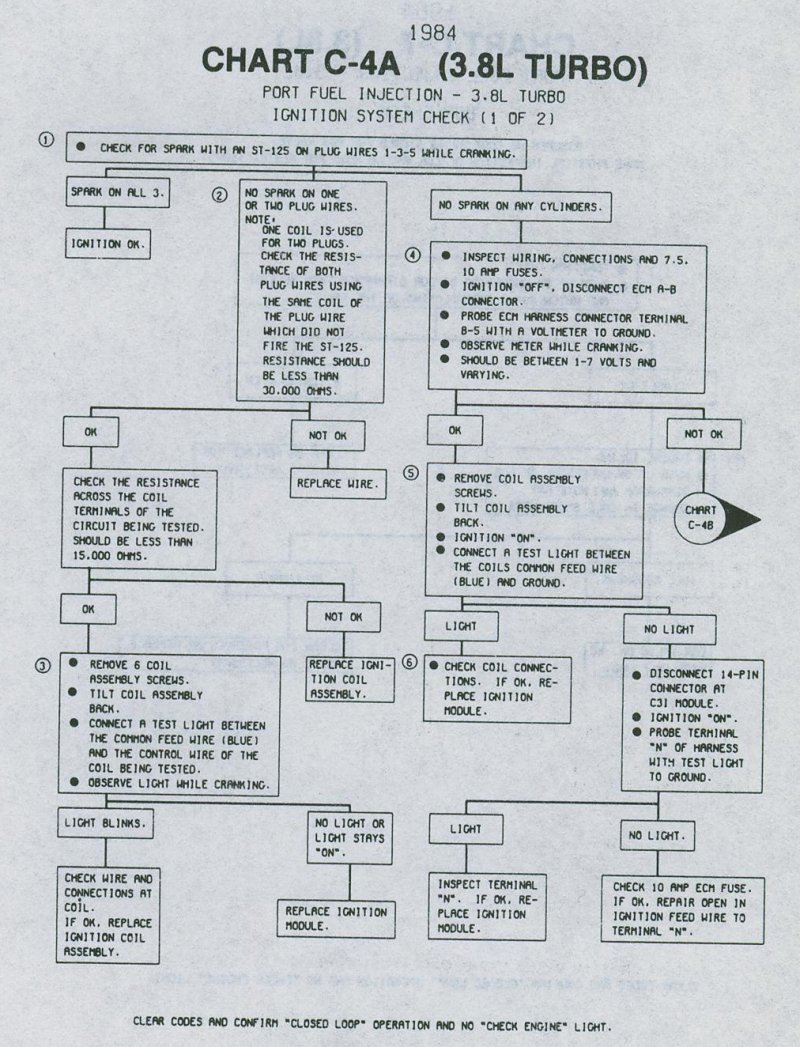

Ignition System Troubleshooting-2 pages
CCCI-Code 41
Cam Sensor Code42

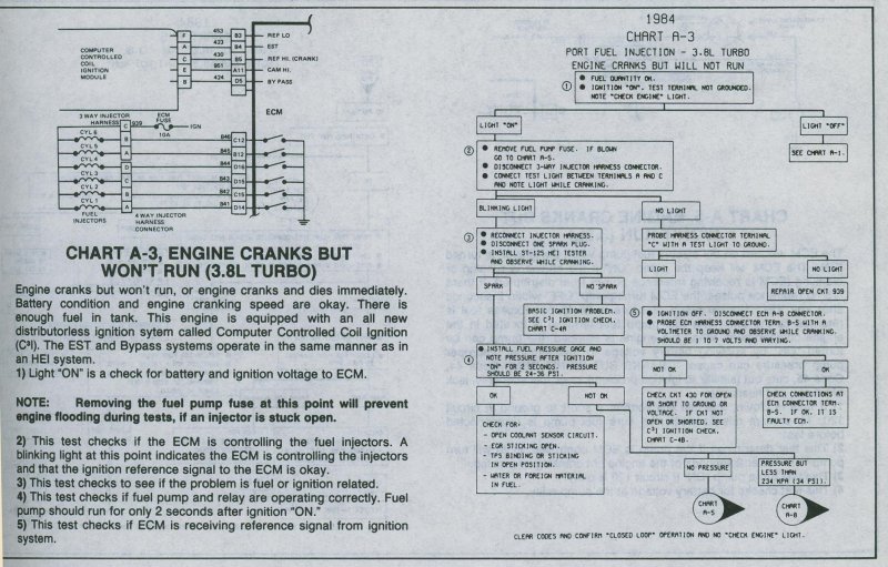

Cranks, But does not Start

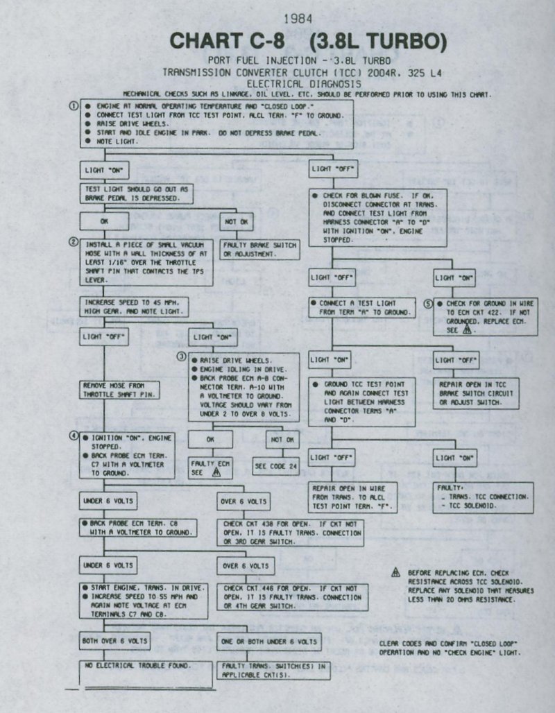

TCC (Torque Converter Control)

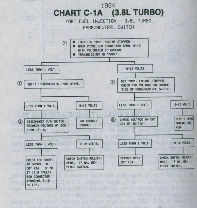

Park-Neutral Switch

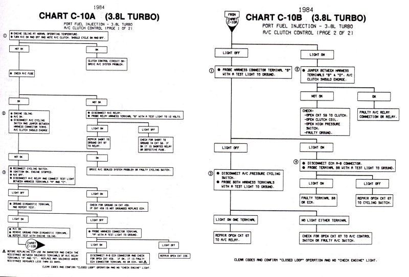

AC Clutch
